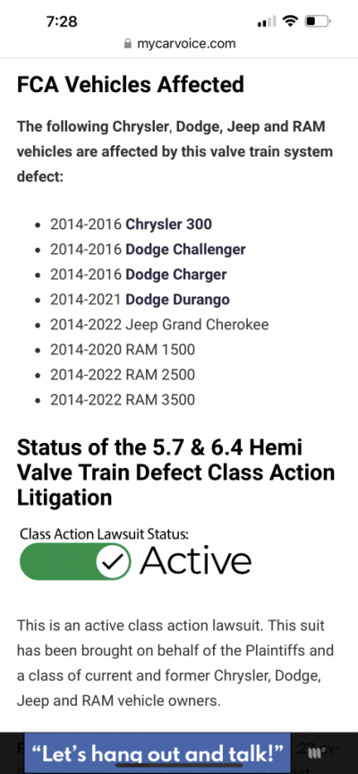

I am reading there are class action lawsuits about this type of issue with years 2014-2020 Ram 1500.

He text me back no codes . I am going to go check it myself now for codes.
A class action lawsuit won't get you enough money to pay for an engine. It's more or less to punish the defendant for their actions, while making the lawyers rich. The people who actually suffered losses aren't made whole.
