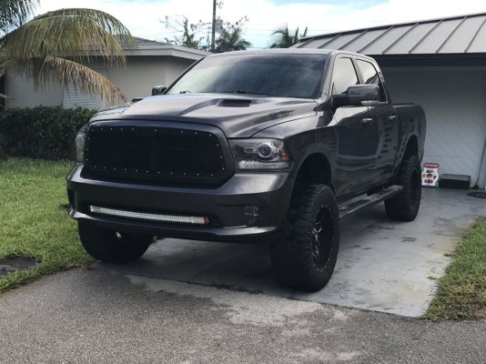

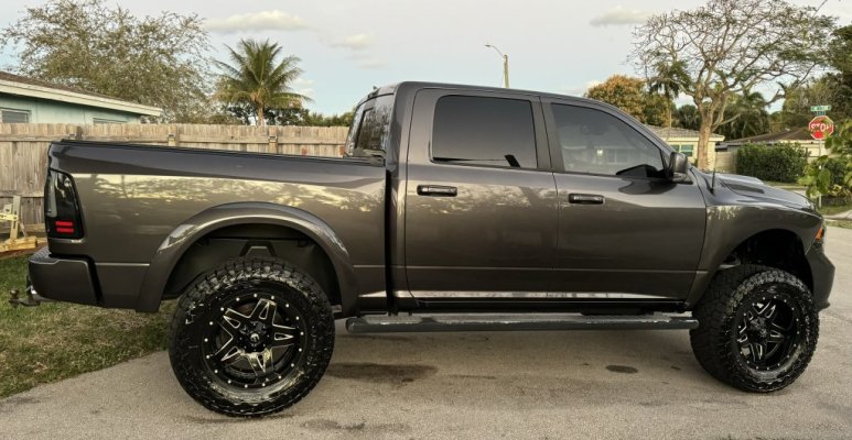

been running max 7” for like 8 years now no problems what so ever other than wheel bearing but that would be from the wheels and tires
