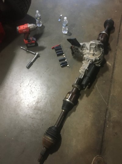

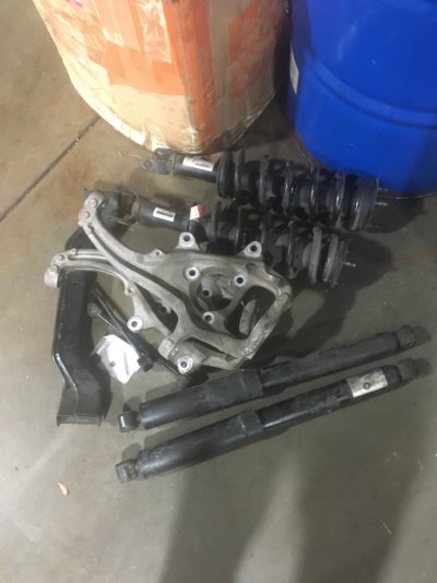

I did the RC 4” and upgraded the shocks then did +70 general springs.it took two try’s to get it all lined up,but it turned out ok. Wish I wouldn’t have bought new tires before I decided to lift it. I have alot of pics because i helped my vette guy whose a RC dealer do it.B4&after.IMG_3164.jpegIMG_0538.jpeg
