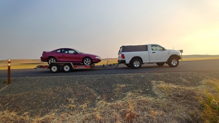

I think that tow/haul increases line pressure, and I did tow.. but that's what it's built to do and i was ~3000lbs below rated capacity.
Stopped to tie up those chains so I wouldn't start a fire in those barley fields.. that stuff has to turn into beer and bread! And yeah I know my tongue weight is wrong, can't pick where you mount the load on a Uhaul car hauler the straps/buckets are fixed in place.
