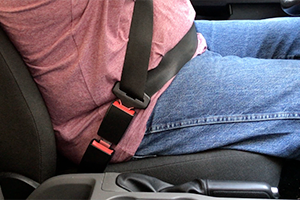

I am large around the waist, if i put on a coat, i have some trouble buckling up, also, if i am only moving say a couple of feet, i don't buckle up.
I bought a pair of seat belt extenders, got the discount
they are very short
but it does eliminate that darn buzzing
