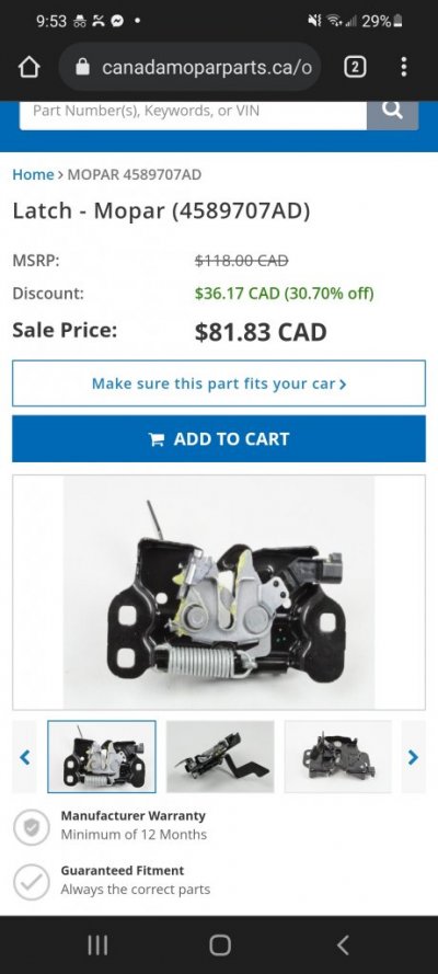

I have bought the latch/switch combo before but I can not find the plug that plugs into the latch. The service manual states that the wiring is stock on all models. Hoping someone can point me to where it is hiding.
