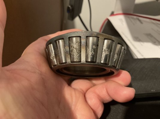

I had same issue, it was the pinion bearing
