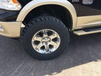

Would like to see some pics as well I'm considering going up to 37s on my next tire purchase!
I just put on Toyo Open Country 37x 12.5 r20 MT on my truck..I have a zone 6 inch lift too. Here are some pics.
