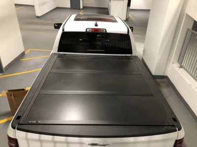

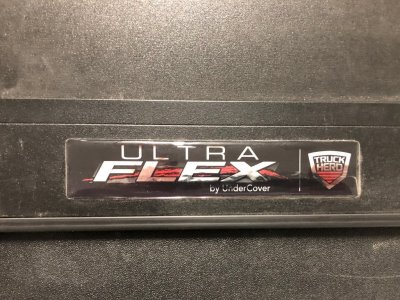

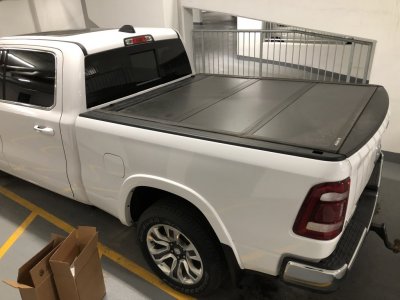

I went with the Undercover Ultra Flex. Step up from my previous cover. It's lined underneath each panel. You don't have to lift the rear panel to close the tailgate. Very nice tonneau cover and excellent seal, I'll post pictures when I get a chance.

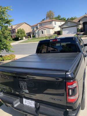

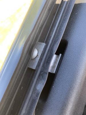

I used my Mopar tri-fold cover from my 2017 Larami in my new 2019 Larami. It is little wider so I had to mount bolt clamps sideways in the stake holes and I had to drill one hole in each tono mounting rail to move it back to the tailgate by 1". Now it fits.

Good job, can you post a picture of how you did that?

The second picture shows the back of the rail I didn’t have to do anything to the screw location for the clamp but on the third picture that clamps to the front stake whole post I drilled new hole roughly 1 inch forward and have the clamp clamping the outside of the stake post hole to maximize the width for the wider tono cover. I know that the new 19’ Mopar trifold cover fits on the inside of the bed so you got to use the stake hole posts for lumber rack at the same time if you want. The new 2019 Mopar cover is almost a thousand dollars with tax I think I’d like the old one for now
