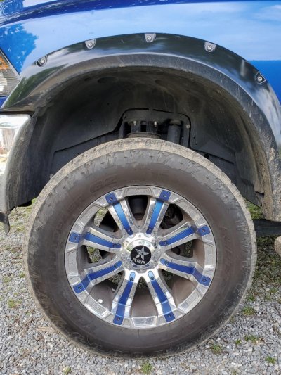

You can put a 35" on it without lift or level. Rubbing depends on the +/- offset of the wheels.
I have 35-12.5/20 on my 2500 4x4 with a -18 offset. There was a slight rub on the fender line at full lock backing up.
So a 35 with a 0 offset would not rub and fill out the wheel opening nicely. 160ddee8837ef4e5619c6b248a51d7e6.jpg

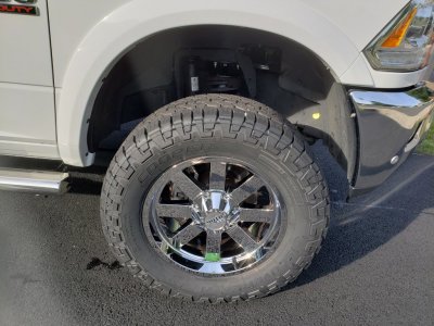

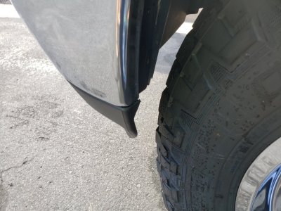

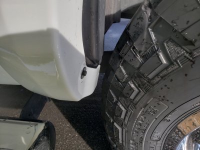

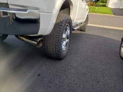

Well, here are the pictures.
The tires are real close to the body at a full turn in either direction but, no rubbing at this time. I tried forward and reverse.
Since the tires stick out a little further than I was expecting, I'll go ahead and add a set of color matched Bushwackers to reduce the dirt and rocks up the side of the truck.
At 73MPH on the odometer, my cell GPS says I am doing 75MPH so, I am not going to worry about changing the odometer.
HOWEVER, the freaking tire pressure indicator is coming on due to the truck expecting 80lbs of tire pressure in the rear. Does anyone know how I can change the truck setting to say 65lbs for instance?
