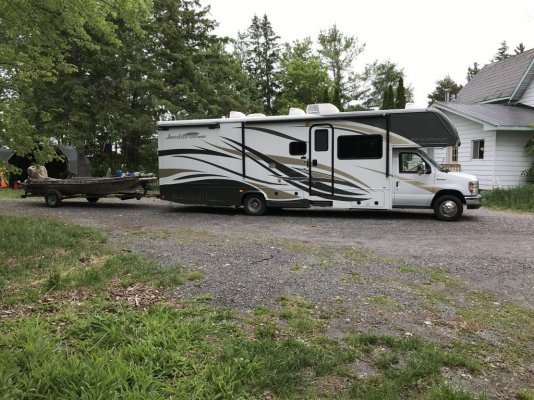

as others have said it can do it but do your really always want to be that nervous driving down the road ? If your just doing it 2 times a year and doing short distances I would say ok you could get away with it but if you plan on doing lots of miles and long trips I would say get the truck you need to do it safely and drive with a bit of confidence on the road. Also being a motorhome owner my self I think just about every one I know has way more weight in there rigs that what’s the load limit just keeping it real good luck on which ever way you go.
