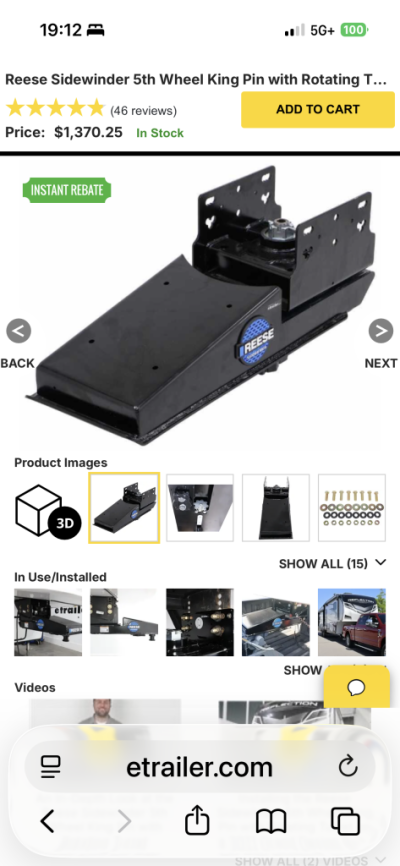

You can install the gooseneck hitch and the four pucks in a Rambox truck, but you can’t buy it new that way.
If you search on line you can find multiple different instances of the installation. The places you cut the holes to install the gooseneck and the four pucks are already marked in the bed floor visible by looking inside the box.
That said the only fifth wheel hitch that will work with the Rambox is the Reese Sidewinder hitch (maybe other manufacturers are making the same thing now).
Traditional fifth wheel hitches on RV type trailers will hit the sides (inside surfaces) of the Rambox.
Gooseneck hitch trailers like equivalent trailers work on the center gooseneck ball. Note the goosebox adapter likely doesn’t work.

Thank you. Are there any negatives to running that hitch vs a traditional hitch? I've never had a 5th wheel personally (although my dad had one in his Ford). Thank you for the reply.
I don’t have one yet either.
That said a fifth wheel is slightly more stable than a gooseneck, but a gooseneck articulates better.
Fifth wheel hitches have the option for a sliding hitch. Fifth wheel hitches are heavier than gooseneck hitches.
Gooseneck hitch is easy to remove if you need to use your truck’s bed and storage easily.

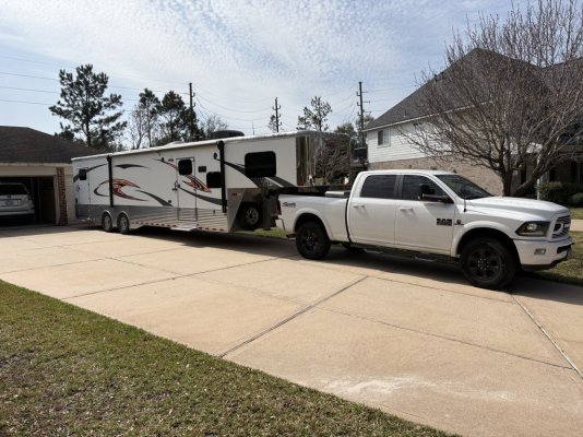

I'd opt for the GN/5er prep (which includes in the bed wiring), but I'm a bit biased since I have two GN trailers. As far as RamBox, I've never had that option so I can't speak to its usefulness vs. limitations; I've always run Weatherguard across the bed boxes in my pickups for secure storage.
