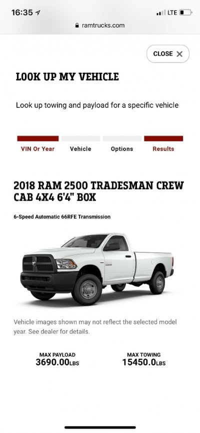

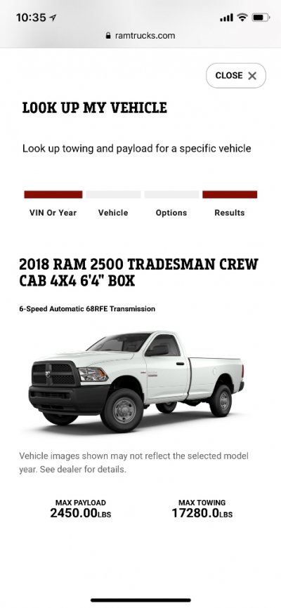

Nope that is about right for a diesel 2500. The one with 3100 lbs was either a gasser 2500 or a 3500 diesel.
This is my truck with a gasser. 2500 4x4
Almost identically equipped 2500 4x4 but a Diesel.
