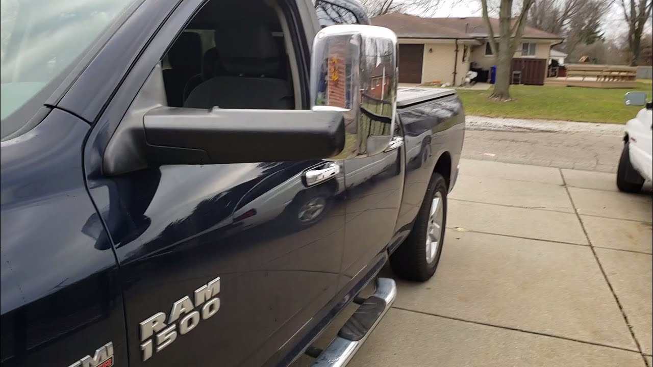

So i ordered brand new after market turn signals and puddle light for my 2019 dodge ram, before i replaced both the signal lights and the puddle light the puddle lights were very dim. The turn signals dint work at all. Once i installed the new ones they dint work at all any one have this issue?? These are the ones i ordered. I did check all my fuses and everything.

Prior to replacement the turn signals didn’t work and the puddle lamps were dim? Have you checked voltage output from the wiring harness?

I have not, i ran out of time as it started raining. But if i have low voltage what steps would i need to take after?

Making sure it has power and the appropriate signal to activate the lamps or turn signals is the first step. Low voltage can be from a number of things that will have to be traced back through the wiring. Corrosion, faulty switch, relay, ground are all suspect.
