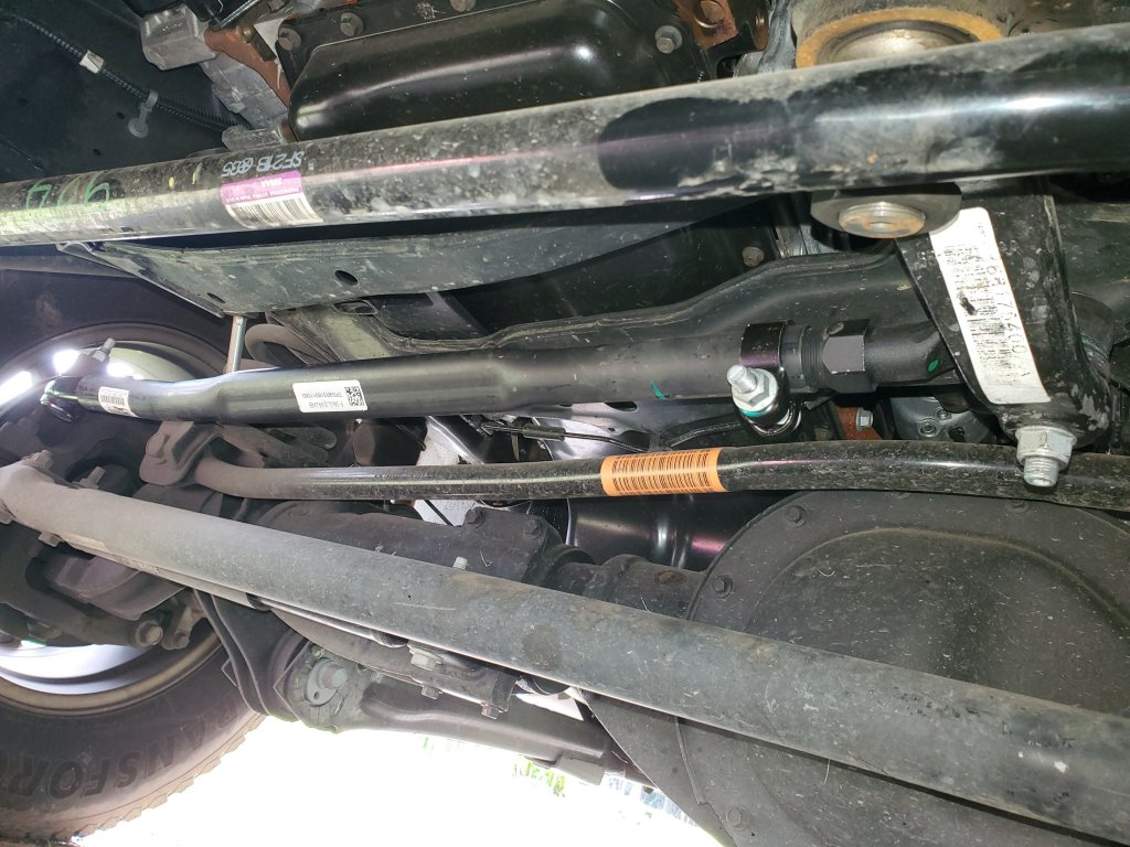

Thanks, just ordered it all. Total with shipping $137.

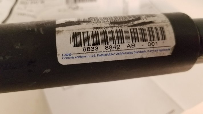

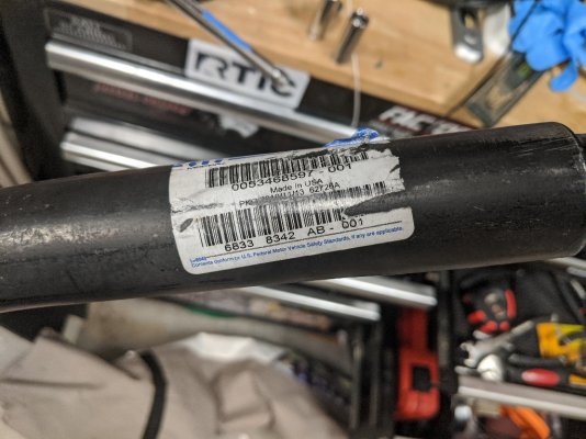

where did you order from? or any one that has got one. also this is for the hole link other than the nuts? 68338342AB no one shows a pic.

Lakeland Dodge Ram.. 863-687-2501 .. the parts people don't have much knowledge about the recall but they do have the part,, just order by part number,,

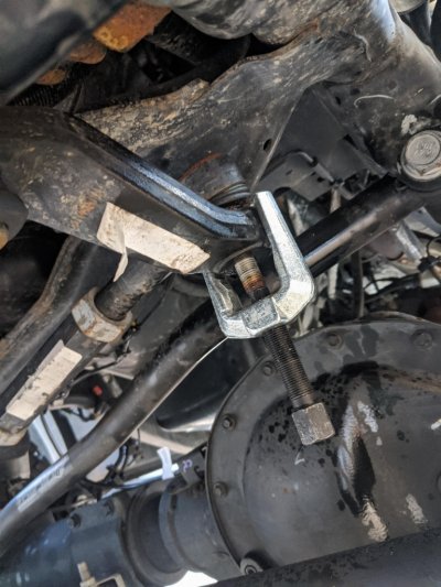

Works like a charm, if you do the install yourself invest in a Pittman arm puller927168e1d89a11defa3bbcd2c6040574.jpg96cc41906073568ca4cc984a978bdca5.jpg

why remove the pittman arm?

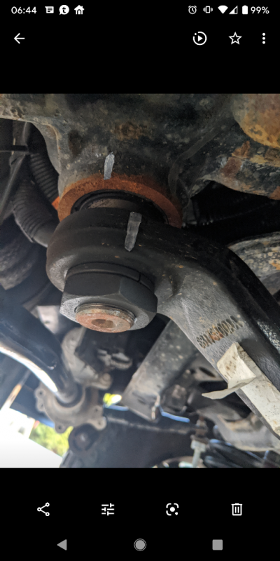

You don't, but you have to remove the drag link from the Pittman arm. The Pittman arm puller has a larger throat opening to get around the Pittman arm. I only had a smaller rod end puller and had to grind away the inside of it to get it on the Pittman arm to press out the drag link9955583b122b985434c8c2f1971ebd37.jpg

ok i get it. i have pickle forks should pop it right out.

There have been some guys that had a hell of a time getting these off even with a puller. Mine popped fairly easily but I had a 1/2" breaker bar on it. Good luck...

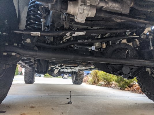

For the link replacement itself, I assume just measure the old link from center of ball stud to center of ball stud and set the new one the same measurement?

I did that and match marked my Pittman arm position prior to removing the old link and used that as well as a get me close guide
