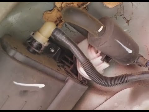

I was just about to make a thread for this but figured I have the same issue and will post here.
2019 Ram classic 5.7
I truck has been fine evap wise but I had a small fender bender so my truck went to the body shop. MN is currently below freezing. I left my truck with just under half or maybe 1/4 tank.
Pick my truck up and they did a full wash, but left it out side so all my doors were frozen. I finally went to fill up gas the next day and it did the gas on for 1-2 seconds click over and over and over. I have tried 4 gas stations and all the same. No CEL's.
Called the shop as they mentioned they may/probably have to pull the bed to paint correctly. And I thought maybe the vent tube was kinked. They Said they didn't pull the box and it is super common on rams blah blah, there is a solenoid at the tank and the charcoal canister.
I have pushed a solid copper wire from 12-2 Romex down the gas fill and feel the spring flap (I think, feels like it) and I have left the truck in my friends heated garage over night thinking it was a frozen/humidity/water thing. No change.
Is there a way to test this roll over ball? Not sure where to go as people mentioned a new gas tank is $3k and I looked up my vin and it does not match a recall.
Here are some videos but everyones fix seems different, except with the evap system it seems they pop cel's where mine/ours have not
wire
how it works
gas fill flap

The first video you linked is actually mine - and that worked for 2 years! But now, the problem has returned. I tried the same fix again (jamming something down the filler, and beating the side of the tank) and had no luck. I can feel the spring valve opening and closing when I push it so I don't think that's it. This time, I have an extra symptom, I can hear the pressure venting slowly back out my filler. I disconnected the hose going to the filter, with no luck. SO next I'm replacing the leak detector, and if that doesn't work then I'm pretty sure it's the charcoal canister is plugged up.
These things are such a horrible design!!! All this EVAP BS is crazy! If replacing the leak detector doesn't work, I may drop the tank and see if I can figure out a way to vent to atmosphere, but it'll likely wind up throwing evap codes afterwards.
