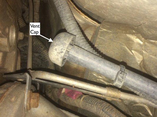

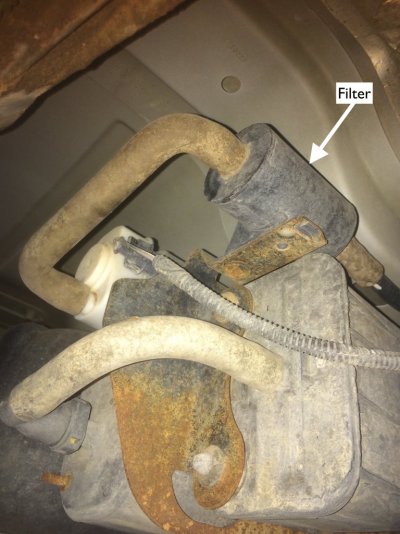

I needed to get gas, so I went to the gas station to fill up. When I took the gas cap off, it let out a big jag of air pressure. I didn't think much about it until I tried filling the tank and the gas pump kept kicking off. Fuel would back up in the filler neck and then just slowly trickle down into the tank. My first thought was that my truck had a bad prostate. But then I remembered the pressure in the tank when I took the cap off. I looked at the filler neck and smaller vent hose that attaches to it and couldn't see anything out of the ordinary (kinked or damaged). Finally out of desperation to get my tank filled, I decided to crawl under the truck and pull off the large vent hose down on the charcoal canister, then it filled normally.
I finally had a chance to look at it again today, so I took the large vent hose off again that goes from the ESIM to the vent filter and tried blowing through it. It was almost completely plugged, barely passing any air.
Next I removed the filter to check that but it was clear.
Besides a rubber and plastic tube that exits the filter, the last part is a vent cap at the end, up by the transmission bell housing.
It turns out the vent cap was full of mud, not from mudding off road, but from a Mud Dauber building a cocoon in the cap.
Anyhow, I cleaned and blew everything out and now my gas tank fills normally again... At least until the next mud dauber finds my evap vent hose.
I hope this helps!
I know of more than one truck from the early 2000's, where that vent line's tie wraps rotted or broke. The line then sagged onto the exhaust and melted itself all or partially closed.
That of course caused the same slow to fill symptom.
I hope this helps!
I had that on a Ram, fixed it, changed all the parts you showed in the picture, tank was not purging the vapors, so the pump nozzle thinks you're full and shuts off.
