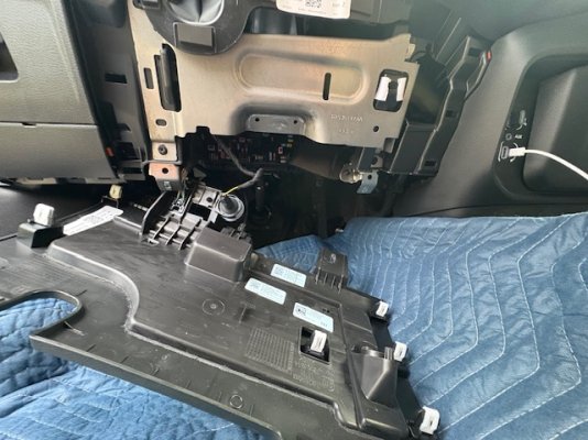

Remove the 2 7mm screws at the bottom. Cover has 7 clips. I started at the bottom right. It pulls straight out.
I also removed the steel plate behind it for better access. 4 7mm screws but phillips head too.

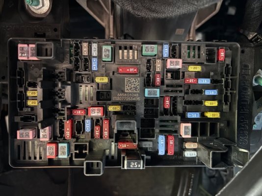

Move F54 20A yellow (bottom right) from left A to right B position.
Now my dashcam shuts off with the truck. Simplest way to connect it.

Looking at your pictures and the 2020 owners manual, the only driver selectable fuse I see is F54 (just below and to the right, yellow 20 amp). It's for one of the power outlets on the dash and you can choose whether to have it in the IGN or BATT position.
That's the one I just did and it is a LIFE SAVER... love having it now be IGN instead of BATT
