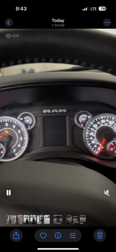

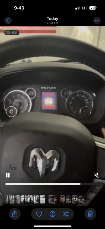

Good morning.
I am having an issue with my 2020 Ram 1500 Etorque.
I went to start it this morning and have a serious of “spazzing” lights, noises from the dash board.
The lights and noises go in and out every quarter second. It continues to “spazz” without hitting the start stop button. I’d say that there isn’t enough juice in the battery, but it’s Repeatedly doing this for a minute or so until it allows me to run the start button through the accesory/run and off cycle.
Additionally, as the truck is “spazzing” i want to say im hearing some kind of start up noise coming from the battery?! That’s my assumption. I have a video but I don’t believe I can add a video to this thread.
The truck has had the same battery since buying from dealership. Additionally the Etorque battery that’s in the truck was replaced the day I bought it.
I only know so much, I’d want to say this is a battery issue??
I drove my truck yesterday for about 15 minutes with know issues at all.
I’ll add some photos but it doesn’t do it justice. The videos are more supportive
To post a video, you need to post the video on a video sharing site like YouTube then post that link in your post.
Check the 12V battery when the vehicle is showing issues, guessing the battery is getting weak. The 12V battery is responsible for powering the vehicle and the initial starting of the engine

Welcome to forum.I’ll add some photos but it doesn’t do it justice. The videos are more supportive
Pictures not focused enough to read.
Very 1st Thought: Battery. These batteries are not going any more than 2-4 years. Entirely too much computer modules are pulling amps and always on, even if vehicle is off. Before you pull battery, check and make sure there is no special steps you need to take to replace 12V battery in an E TQ vehicle. There may be a special order you need to do, as I do not have E TQ.

Thank you for your reply! I posted a link farther down for the video of what is going on.
I am curious if there is a special method to replace this battery. I’m under the assumption it’s the same as any regular disconnection for a vehicle.
The battery is almost 5 years old, so I’m hoping it’s just that. I guess I was just shocked figuring I drove yesterday and didn’t notice any issues.

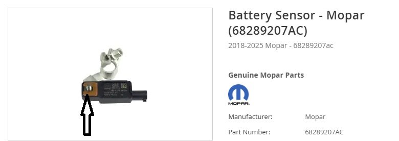

Hey listen I truly appreciate the reply. Where would the ground on this be if you have any idea?
Secondly would my local O Riley’s be able to do a battery load test?
Multiple grounds: Easiest to get to: Insure tightness of Positive/Negative cables on battery. Also, on top of negative cable, should be an IBS sensor. Check also that the other cable to the sensor, which goes into harness is secure, think 10 mm.
Maybe on O'Reillys. If they use older analogue one like I listed above, be great. Digital work, but are known sometimes not reliable, why I posted URL if U were thinking
of getting your own, post #3. Pic what IBS looks like: That is mounted on Negative cable. Arrow points to bolt on IBS U need to check. Got pic from Mopar Parts using 2020 Bighorn, yer motor selection.

No you are right about the battery. Not that I heard about the issue with OEM, but it is a good idea I replace it after the length of time.
I’m not sure if you saw the clip I posted above in the thread. Do you think it’s consistent with a low voltage/bad battery?

Sorry stupid question but IBS?
I saw the clip. I can't say if it's consistent with a low voltage condition since I never experienced that. But that's the first thing I would suspect if I saw that on our truck.

TurkeyBird has a picture of the IBS /intellegent battery sensor in post #10,it's on the neg battery cable.
only stupid if you don't ask, when you don't know.
As mentioned above, Intelligent Battery Sensor. It monitors the battery temperature, state of charge, etc. Sorta like voltage/amperage meter but a lot smarter.
If you have a voltage meter you could see what's happening with the current battery voltage when the dash is flashing like that. You can't rely on the voltage reading in the dash. If the battery voltage drops too low vehicles start doing strange things and they'll even shut down if the voltage drops too low. Guessing a cell within your current battery has gone bad and the voltage makes a sudden drop when put under a load.
