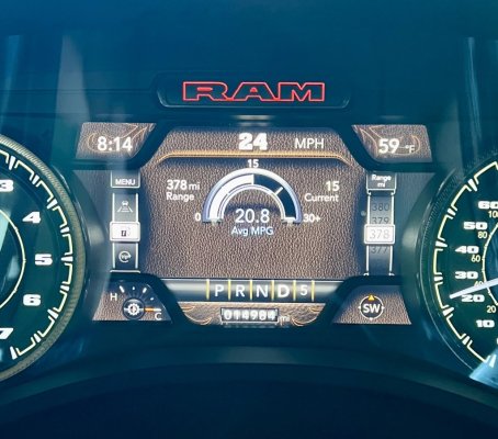

Afternoon, in July 2025 I bought a used 2020 1500 Lamarie with 27500 miles. Drove it for 2 weeks and had the same problem as you. Took it to shop no light. drove 1 wks. light on. back to shop then they keep it for 12 weeks. I tried to trade it back in but would have loss 5,000.00 dollars. Called Ram cares. They put a new 48 v battery in got it back been driving it since. All has been good. And round town now 17 - 18 MPG and on the road 21 - 22.5 MPG. I was just getting the run around until called Ram Cares got involved . I have had 3 - 5.7 Him all had been good. The 22 ram now has 31000 miles on it now. Good luck with yours.
