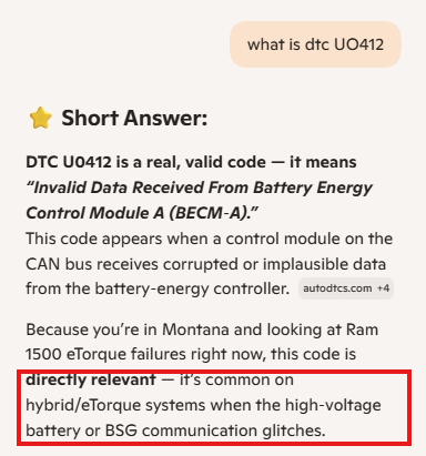

I recently purchase a new RAM. 1500, 5.4 Hemi with Etorque. I started getting trouble codes at 800 miles. PAOCO and UO412, both Battery codes for the Hybrid system, I think.
I took it in when the codes first came on and of course the check engine light was off the morning I took it in. They kept it for a week and finally gave it back claiming the check engine light never came back on. The codes came back on for me a few days later. Took it back and they again they kept it for a week and said they couldn't get the check engine light on and gave it back to me. Then they came on again for me a few days later. Took in in a third time and they had a "master electrician" look at it and they are telling me they think it needs a new Hybrid battery. As of now it has been 10 days and they can't give me an ETA on fixing this.

When the dash lights up like a Christmas tree, take pictures for proof because it is time and date stamped, then you can show it to the dealer mechanic .
