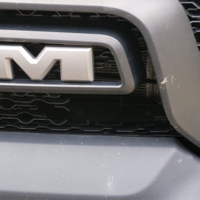

Hi Everyone,
I have a 4th gen, 2020 1500 Warlock. Some kind of partridge decided to jump into it at highway speeds. This fractured part of the plastic grate. I've heard people say that you can buy parts of the grid and others said, sorry, it's a $900 replacement part.
I want to sell it soon and would prefer to fix it first because it is perfect otherwise. I'm not looking for a new kind, just a parts solution. I'll post up a pic. I'm new to RAM's and love mine, just haven't gotten to work on it much yet so I'm clueless. Thanks, Ben.Grille.jpg

Have you consulted with a Ram dealer part’s department?

Have you already replaced your Rams Grille
Take the insert out of the broken grille
Then take another picture or two
It looks like the inserts run around $130

Hi fellas,
I haven't spoke with the dealer yet. Because I know it'll mkst likely cost double to buy there, but I might have to.
I also haven't tore it down to check it out inside due to all the plastic shrouding in the way because I just have a very major surgery and am being easy.

130 wpuld be not sp bad at all!!!
