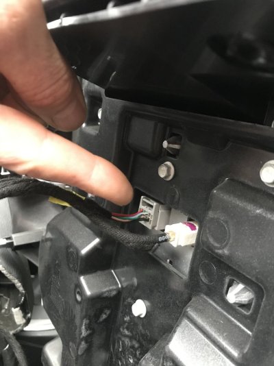

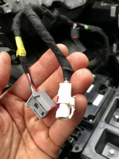

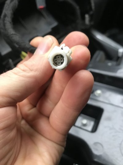

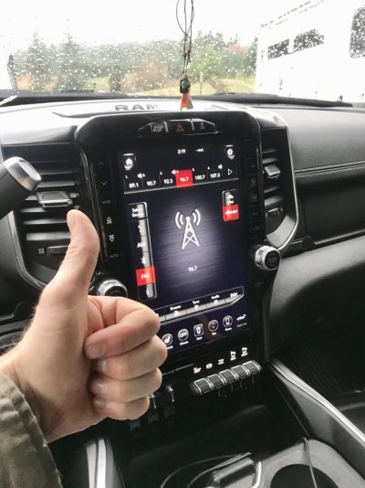

I just got it sorted. Turns out i didn’t have the round white connector all the way installed. There are a total of 5 connectors that plug into the back of my 12” screen assembly. The very top is for the 12v cigarette port, two middle ones are for the main screen, and the two bottom ones are for the the aux switches and the trailer brake.
Knowing that only the two middle plugs power up the screen, i focused on them. I then mainly focused on the white round connector, just because it was a different shape plug and looked way more important that the square grey plug. I pushed the white plug in really hard and the screen briefly turned on then back off again. So obviously that was the offending spot. I then pressed the plug in REALLY hard and rocked it back and forth. I did not hear an audible click, but it was now VERY solidly connected. I then reinstall the screen and it’s all good to go! I’m VERY, VERY relieved! Especially since this is actually my sister’s truck. 9EE6094F-F1EA-4859-8F64-702BD862B74D.jpegB4509303-2C7B-4264-89E4-4F6662E0BCCA.jpeg62FE9CD4-07A0-4FA7-984E-C9BAF66478CD.jpeg6FE951DB-FC3E-4018-9374-E8EEFD6FA808.jpeg5944925A-B76D-440A-B461-5DCE99EE3CAF.jpeg
