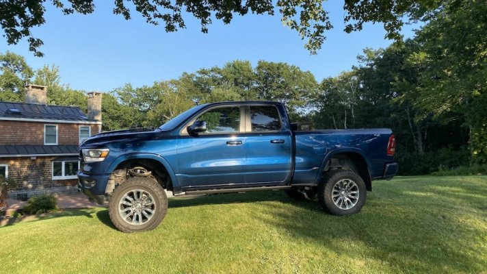

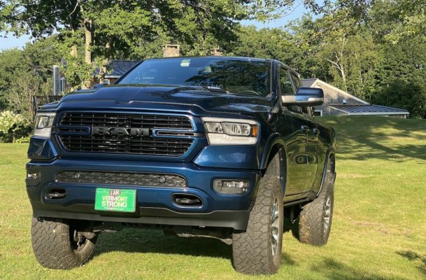

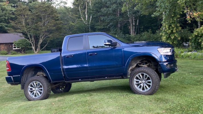

I have the Rough Country 5" lift on my 2020 1500 with 4C Air Suspension. I have 35 x 12.50 on the stock wheels and 1/2" spacers. Very slight amount of rubbing when turned all the way to the right (none to the left).

Here are a couple. In OR2 position.
