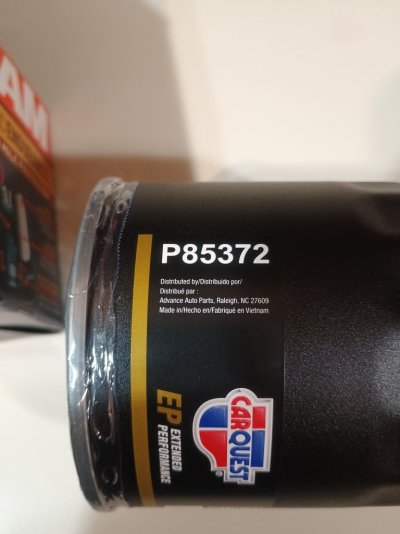

I have been through a ton of posts and I was hoping someone would help me consolidate the information I am looking for. As my title states I have a 2021 RAM 1500 5.7L eTorque and I recently discovered that the Royal Purple 20-820 oil filter that I am currently using has been DC'd. I really want to continue to use the oversized oil filter but I cannot find a consolidated list of these types of filters. If someone could post a list of the brands and model numbers that would make a quick reference for others who are now searching. In all my searching I think I am leaning towards the Carquest Premium 85372 or going OEM with the MO-899 but I would like to make sure that this is the best option.
I know this subject has been beat to death but again I couldn't find a post that lists all of the oversized oil filter options. Most posts just list the brand but do not necessarily list a model number.

Purolater Boss only synthetic left along with Carquest premium or extended performance,
pbl12222 is small replaces rp 10-48 = pbl24651 is larger size replaces rp20-820

With Fram synthetic out this is the one I will run. Car Quest EP 99.5% at 20 microns. Same size as RP 20-820

So it looks like I'm looking for one of the following filters that still uses the synthetic media.
CarQuest Extended Performance P85372
Purolater Boss PBL24651
I think I will go with one of the CarQuest filter and hopefully they don't discontinue them too.
