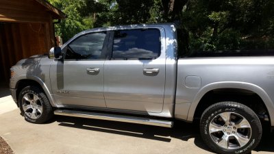

20180901_123937.jpg mine has the ORP and is right at 80" to the top of the fin. I have a 9070 door and the opening is 83" tall so my '19 laramie has only inches to spare ht. wise and about 2" of clearance on each side at the mirrors.
