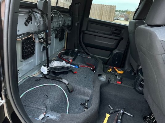

The stereo was the first upgrade to my truck with just under 300 miles on it and was well worth the effort. My recommendation is to do it all at once. The factory speakers are junk and you'll be adding an amp for the sub anyway.
I added a Fosgate 10 under the rear seat and replaced the door speakers with JBL Club 6x9's, front and rear. I ditched the dash speakers altogether. Everything is powered by a 5-channel Pioneer GM-DX975 and tied to the factory head unit with a PAC Audio AmpPRO AP4-CH42. Don't forget the ANC bypass harness.

Which box did you use under the seat? And are all 4 doors 6x9s?

I replied to your PM on amp location, but here is a photo.
