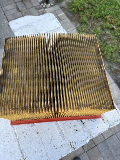

That is the way mine is as well, except mine seems to be more in the center. Couldn't believe the amount of ladybugs in there this time.
JayLeonard
Oct 5, 2019
883
1,131
Florida
6.7 L Cummins
The one i replaced last month.
