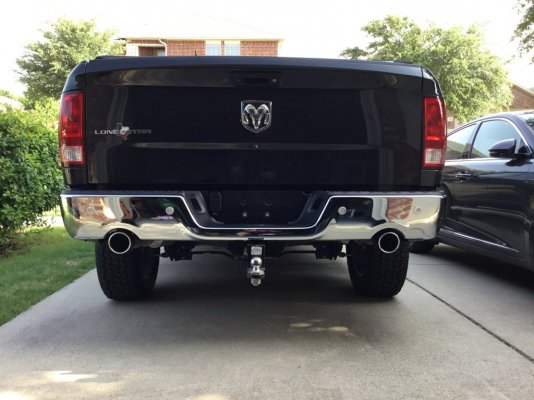

The V6 comes with single exhaust, being that the Warlock is the 4th gen or Classic you can install the exhaust from the Hemi as long as it comes from a 4th gen.

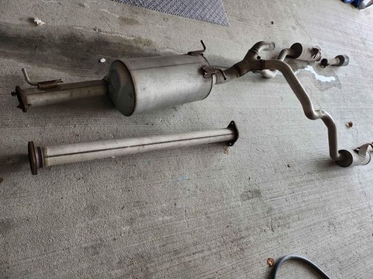

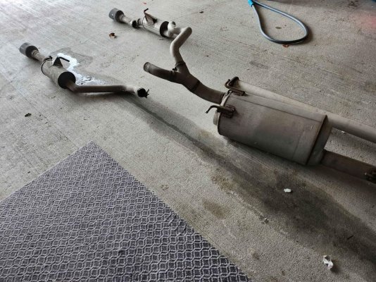

Does anyone know if this is missing anything to do the conversion?
It's from a 2021 RAM Rebel
