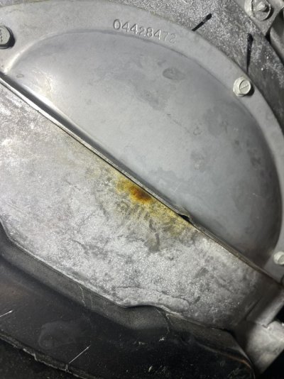

Just an update, today I noticed oil spots on my concrete garage floor. I got under the truck and saw oil leaking from what appear to be the rear main. Truck currently has 300 miles on it. Service appointment is on Wednesday.
I’m pretty pissed off.

Very understandable. For what these things cost, you'd expect no issues till about 400k miles at the soonest. Good news is you've got the whole warranty left, don't let them hose you. It's a shame but nowadays I don't take a brand new truck very far from the house for a while just to make sure it's good to go.
Theres a small chance that what you're seeing is residual assembly oil. It happens on brand new engines, especially cummins engines, but it generally isn't enough to drip. If they give you that explanation, than by now it should be done weeping and not show up again after a wipedown.
As far as the squeak goes, could just be the belt. I'd be far less worried about that than the oil under the flywheel.

Mine is at the dealer now for a rear main seal leak. Matter of fact, I have to call them today and see if it's ready. Dropped it off last Monday and they said they were 3 days behind, so I figured I'd give them a week. The leak was discovered in March when my mechanic put it on the lift to change the oil. Showed me the drop hanging from it. And I had my truck for a year so it wasn't residual assembly oil.

They said the oil leak was just the anti- corrosion.
