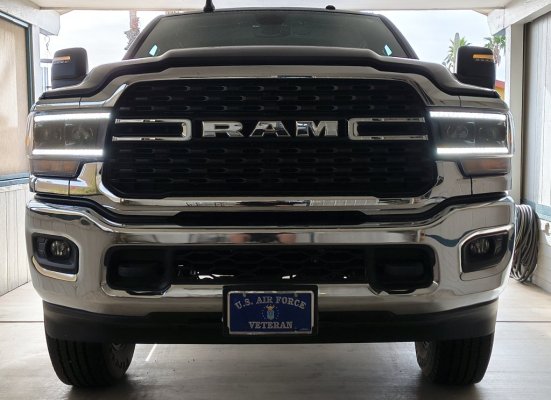

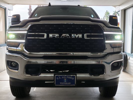

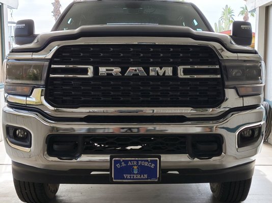

I have updated my OEM halogen headlights & turn signals with some Morimoto XB headlights and some 7440/7443: XB LED Bulbs.
I have an interesting hyperflash issue. When I use the turn signals one or both bulbs on one side or the other will work. It's very random. The turn signal lights in the outside mirror case will hyperflash but not the turn signal bulbs under the headlights.

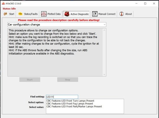

There is no access through my UConnect to do change any settings for the turn signals. Am I right in assuming that there is a setting I can access via AlfaOBD to set the turn signals to LED? Or is there something else at play here?
Also, regardless of the headlight switch position, my low beams are always on when ACC or RUN power is on. I'd like to run the low beams when the switch is in the headlight On or Auto positions and I'd like to run the two LED bars when the headlights are on and as DRLs.
The installation was pretty straight forward and everything was triple checked during installation.
Thanks in advance for any input you may have on the issues.

Yes, AlfaOBD can access the light bulb types. Lights staying is normal but mine only do it when the vehicle is in gear. Alfa can access that too, but there should be a settings on the vehicle settings pages of your radio that allows you to turn some of that stuff on or off..

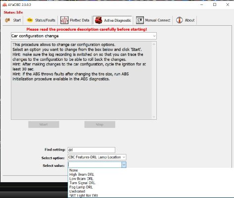

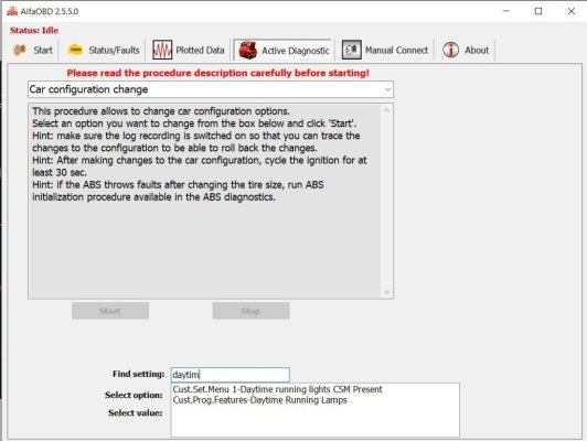

Were the low beams always on during ACC or Run, prior to the LED upgrade? Sometimes they use the low beams as DRLs. This can also be set using AlfaOBD.
How do the two LED bars behave now? Do they stay on when the headlights are off? As far as I know, they should already be configured as DRLs.
If they are configured as DRLs, turn off with the headlight coming on, and you want them always on, the DRL dropout setting can be disabled with AlfaOBD. Just set this option to 'No'.

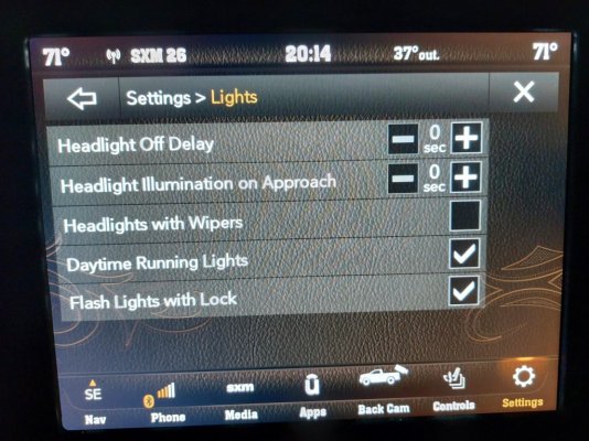

Many of us have chosen to have the ability to enable or disable DRLs through the Uconnect options.
This option can be added to the Uconnect 8.4C, although I'm uncertain if this will function for your radio. The AlfaOBD tweak for this is the first item below.

[Many of us have chosen to have the ability to enable or disable DRLs through the Uconnect options.]
I have the same setting enabled. I just don't want the low beam to work as the DRL. All I need for that is the two LED bars.

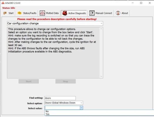

2. Global Window Down

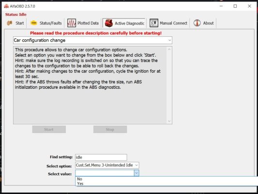

AlfaOBDUnder Cust.Set.Menu.3 - Car configuration change: Unintended Idle Alert: Set ' YES ' to ' NO '

AlfaOBD lamp location/disable low beam DRL. This should prevent the low from staying on.
It sounds the LED bars are already behaving as you wish. If they are just as you wish, no further action is required.
I likely confused the issue by mentioning to disable the drop out feature.
That should correct the outstanding concerns and disable the fog lamp dropout.
I periodically use this feature in the hot summer months. I drop the windows down to exhaust the hot cabin air as I approach the truck.

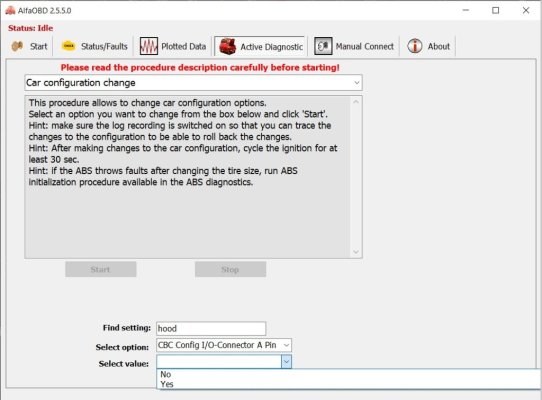

3. Remote Start - Keyfob skin & circuit board? Hood Latch Mod?
I'm not certain what you're looking for here. There are a few AlfaOBD settings if you're adding a hood ajar switch.
CBC Config I/O-Connector A Pin 11: Hood Ajar Switch Input Present

6. Three horn honk turn off
AlfaOBD
More to follow after I get more firewood cut and the expected snowstorm arrives. :cool:
