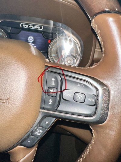

My 2025 Ram 1500 is equipped with ACC. I can activate it and it works properly. I can adjust the distance settings and that works. However, according to the video and the owner's manual, there is supposed to be a four bar indicator light on the dash to show how much distance has been set. My truck does not show that. Only that ACC is active.
My salesman can't figure it out, and RAM Hotline doesn't have an answer. I'm trying to understand it that's working as designed or if my indicator lights aren't working.
Do you have a button like the one circled in the pic on your steering wheel? You should if you have ACC. Pressing this button allows you to select the desired distance for following.

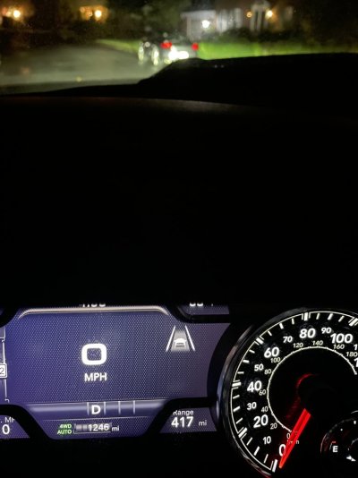

It shows up on the right side of my speed indicator on my 2025. The bars will turn green once you hit set or resume.
