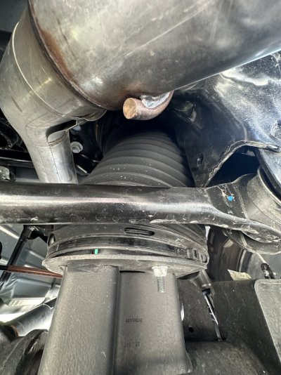

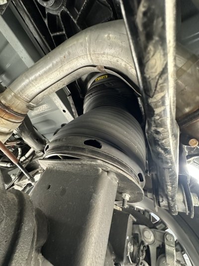

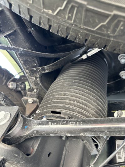

The bags on my 2500 sit weird. My driver side bag sits normal/straight, while my passenger side bag sits angled. I just had the passenger side bag replaced because it was faulty. It's been holding up so far but looking at them it doesn't seem right the way they sit but I don't see a way to adjust the position of them. They rub against the frame.
Anyone have a 2500 with air ride for reference? I don't know if the 2024s and older are similar. I'll attach some photos of the driver side and passenger side.IMG_1310.jpegIMG_1306.jpegIMG_1309.jpegIMG_1301.jpegIMG_1308.jpeg

Whoa - I can’t answer your question but I can’t believe that left side one is normal as pictured. Did you ask the dealer about it?
Waiting on a call back from the techs

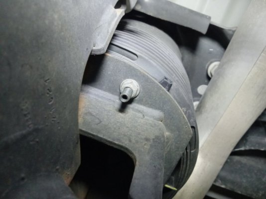

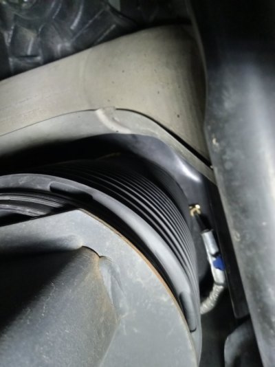

I can answer your question. Thats NOT normal. Unless they have altered the mounting positions of the bag mounting on the axle? Both of my rear bags are straight. The one you are showing looks as if it was damaged by exhaust heat? Thats the same side that mine failed at 12k miles. Here is both of the bags the right photo is the passenger side.

Thanks man, yeah I'm gonna drop it off at my dealer, idk if they installed it wrong or what but the tech said it might of rolled itself into a kinked position.

Is it possible there's more than one similar part? The one looks deformed maybe because it's too long?
