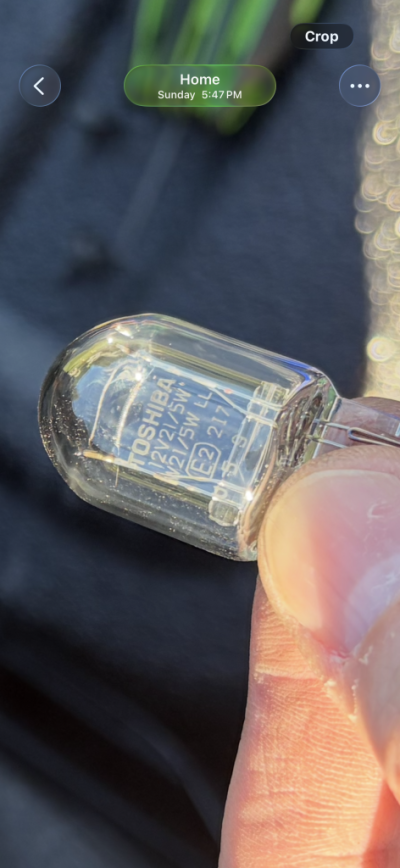

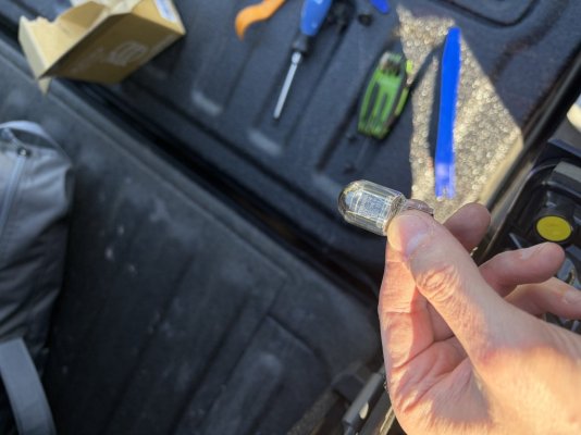

Only 5K miles and one of the taillight bulbs went. Almost no automotive sites list the correct replacement bulbs for the 2026. Tried Amazon and both they listed as “fits” that I ordered didn’t fit. Any advice?
For reference, Here is the factory bulb I pulled from the truck.

For a 2026 Ram 2500 with incandescent tail lamps, the primary tail, brake, and turn signal bulbs are 7443.
If your truck has LED tails, then this would not be the right bulb as when the tail light function fails you have to replace the entire tail light component.
