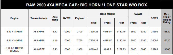

How far and what terrains are you towing in? I just towed my 5w, which truck and 5w combined was 18,500. The 5w GVWR is 11,000. My trip was from New Hampshire to North Carolina and back, so around 1800-2000 miles. I think the truck did quite well. I'm running 285/75/17's and leveled. You'll need airbags. I towed long grades, but nothing beyond 5% or at any high elevation.
The gearing, IMO, is pretty close between the 3.73 and 4.10 with the 8HP75 in front of it that the rear gear ratio isn't nearly as critical as in the 66rfe with the larger spacing between transmission gears. No gear hunting with the 8HP75.
With that said, I've never owned a diesel but I'm told they do a phenomenal job of pulling and get about 20% better fuel economy. But then there's DEF and the issues that go with it, the up-front cost of the diesel, and the long-term maintenance costs of the diesel. A mega cab Cummins 2500 has crap for payload and towing ratings on the new trucks.

I wouldn't jump into a 2500 with the diesel, you'd loose payload vs the Hemi.
