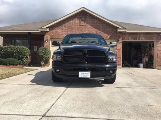

Stealing a pic from Demon-HeMi, you can see the holes for the tow hook mount on each of the bumper brackets of his black truck with the sport front end. I know the standard front end has the same brackets, since I had that on my truck before swapping to the sport front and I reused the standard bumper brackets. The question is if the tow hooks clear the standard bumper. My guess is that they will if you get the tow hooks from a 2500 that had the standard chrome front bumper.
