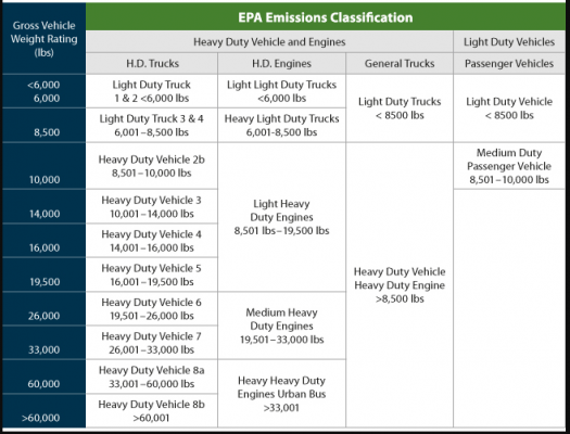

The payload of the 2500 is limited by EPA NHTSA class regulations, not actual carrying ability of its individual parts which are identical to the 3500 aside from the rear suspension. The back end of the 2500 diesel can easily and safely handle at least 3.2k just like the gas version of the 2500. My 2500 diesel has a rear GAWR of 6,500 lbs while the 3500 is 7,000 lbs while the front is the exact same so only 500 lbs difference in axle ratings.
However, the 2500 is in EPA class 2B(HDV2B) which has a max GVWR of 10k of all vehicles put in that class. This is why all Ram 2500's have a max GVWR of 10k even though the actual ratings of their parts are the same or slightly less than the 3500. The EPA class 3(HDV3) that the 3500's are in maxes out at a GVWR of 14k so there is a lot more wiggle room which is why the SRW 3500's are around 11-12k GVWR.
These EPA/government mandated numbers are only meant for manufacturers for emissions and highway classifications and are not abiding by law to the consumer.

The EPA mandated numbers are in no way legally binding to the consumer. It is only a regulation that has to be there in order to sell a new vehicle in the US. In many states like here in Texas, you can legally register your truck for a higher GVWR than what is on the sticker. I also find it funny that people abide by this sticker yet will not think twice about getting new aggressive tires that have a lower rating than the factory tires which is what that sticker is based on.
The main reasons why Ram has a truck capped at 10k is due to fleets. In many states, any commercial vehicle over 10k requires a limited DOT to drive and the taxes/registration are much lower than the class 3 trucks . I know in Texas, the annual registration for a class 3 truck is double that of a class 2B.
In fact, the punishment for getting caught in Texas for going over your registered GVWR is that you have to pay the higher registration fee of the class that you got caught for all the years you have owned your truck and from that point on with that vehicle. That is it. Lawyers can't use this as a reason to sue because Texas legally says you can.
I work for a medium/heavy duty dealer group that owns 9 Ford truck dealerships. We mainly sell to fleets. Ford actually has an option on the F350 that allows you to decrease the GVWR from 12k to 10k for this very reason. The same thing was done to the F450 to make it a class 3 vehicle. It is very popular with many fleets and saves them a lot of money along with the headache of DOT driver license requirements. In fact, this is done all the time in the medium/heavy duty industry with other brands we sell like Peterbilt, Navistar, Hino, and so on.
Rams approach to this is to just make a beefier 2500 that can handle about the same weight as the 3500 SRW instead of having a 3500 de-rate option like Ford. One of the biggest myths is that these numbers are legally binding to the consumer I cannot for the life of me figure out where they got this info from. I have heard of people being ticketed for going over their registered GVWR, but never their door sticker GVWR. I wonder where this info is coming from.
