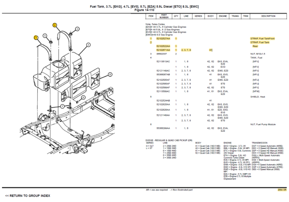

My fuel tank straps are gone off a 04 1500 5.7 i bought recently. Searching on ebay all I see are straps for 34 gallon tanks. Mine has the common 26 gallon tank. I read the front strap is different on the 34s but not sure if that person was credible.
Are the tank straps the same?

It does. Go to rockauto.com and look for the part. Note if it's the same part number or not. If it is, it's the same part.

Hilarious . I looked on there at each part number and compared and it still didn't help me decipher which one will or wont work. From my research i believe only the front strap is different

To clarify, it doesnt list the cross reference on ebay straps vs rock auto part numbers and or mopar part numbers. Im not paying rock auto prices vs ebay prices.
I bought a set for an old 04 26 gallon tank i had on ebay but the seller isnt selling them anymore

Rear strap is the only different one among the various tanks. 52102527AA has been superseded by 52102527AB. 52102522AA has been superseded by 68299820AA for 34 gal tank. 52102671AA has been superseded by 52102671AB for 26 gal tank.
