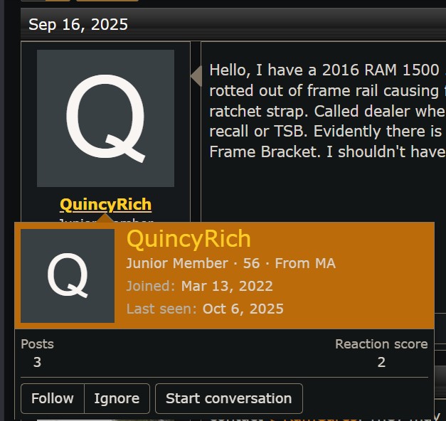

That's great info to share.
In future, if using a PC, mouse over the username, on phones, tap on the username to see the last online dates.
The OP has been MIA since 10/06 last year. :cool:
