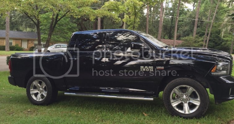

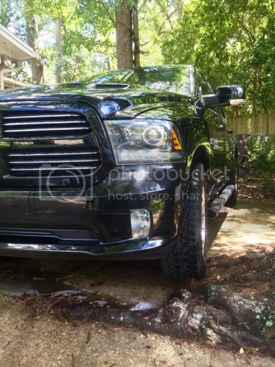

I have the same setup on my truck so I'll share my experience. 13 Sport 4x2 with 3.21 and the 8spd.
I put 275/65/20 Toyo at on a few months ago. Mpg went down about 2 in the city/ Highway about 1. I have a diablo canned tune and my truck is faster than it was stock. The biggest difference is the truck is quicker to down shift on the highway instead of holding the gear (especially when towing something).
K
kal5923
Mar 1, 2016
30
8
Thanks for the insight and pics! Just was I was looking for. Thanks for the help!

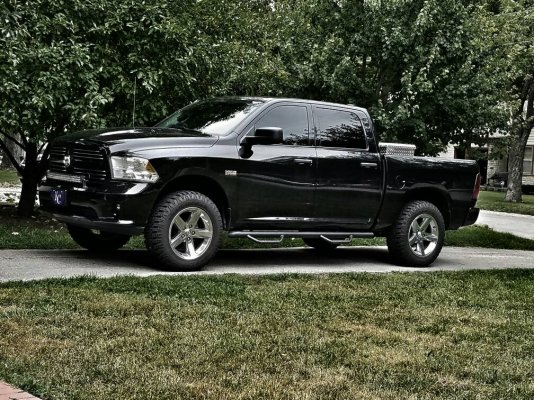

My truck is lifted some but I have 275/65's
K
kal5923
Mar 1, 2016
30
8
Looks awesome! Did you experience any power reductions with the larger & heavier tire?
