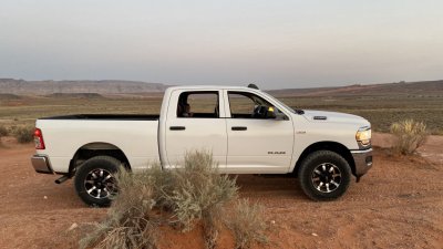

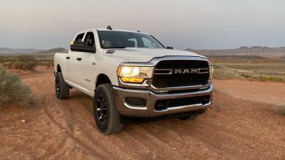

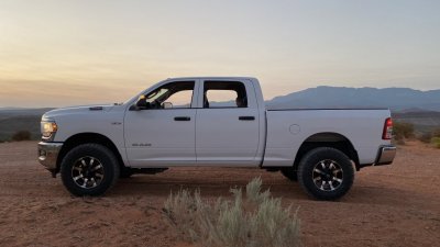

I pondered this question for weeks, and was even told from virtually everyone I spoke with at Discount Tire that 285/75/18 wouldn't fit on my STOCK (no level or lift) 2019 Ram 2500 Tradesman. They told me I wouldn't be able to even get out of the parking lot due to how bad it would rub. Well, they were wrong. I did my research on this subject and I made my final decision to go with 285/75/18 with a wheel offset of +18. No rubbing anywhere whatsoever, on road OR off-road.
