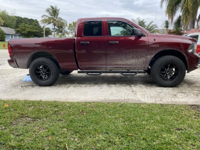

The eibach coils got me 1 1/8” in the rear and ride very well. They’re progressivecrate like the icon coils but come with coil isolators so they don’t chatter. Also seemed to level my truck back out for the most part. Have 2.5” lift in the front currently and lifting it to 3” in the front here soon. Has about 1” of rake.

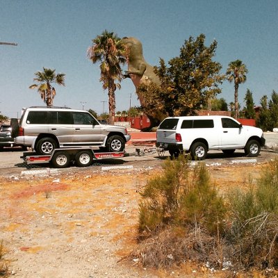

The Mopar 2" springs are the SLF-140 by Superlift. They don't raise the rear more than 2" unless you had perhaps a single cab truck. They're the longest spring by far we can run considering they're just for 2" lift, but they wont take the weight of a cap very well. They seem to have very soft spring rates. I sagged their entire 2" in just couple of weeks (my truck rear is 500lbs heavier than stock). Icons will take that weight better. I've had Icons for about 2 years and just recently i had to add 1" spacer to counteract the effects of the weight i have in my truck (mostly looking to add a little bit more height considering i run 37's). I went with SLF-140 because they're advertised for 2" lift and thought i was going to get an extra 1/2" with those. They lasted 2 weeks under my truck weight as i said. Bought them from summitracing and they didn't have any issues accepting my return and giving me back a full refund, no questions asked.
