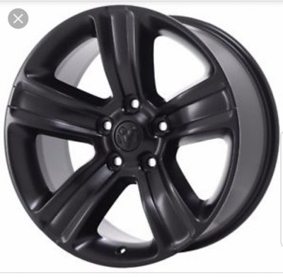

What size wheels do you have and what’s their backspacingand offset?
I have stock sport wheels as in the added picture with 35x12.50x20 tires so not sure what the backspacing or offset is on them. I also have a 10mm spacer behind the wheels
A quick look I found shows 19.1mm offset and 5.75 backspacing on the stock 20x9 wheels that I have

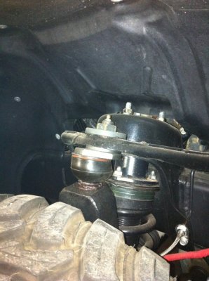

I had a similar issue with my truck. I decided to replace ball joints using MOOG problem solver ball joints in my stock control arms. They are lifetime warranty and I have had zero issues since.
