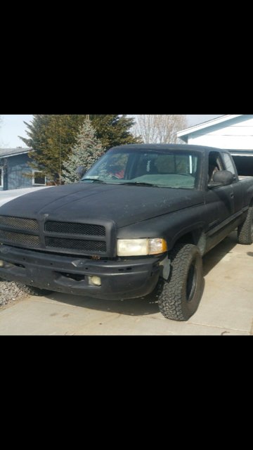

This was it when I got it.

That is to be determined , but I have stated that the front axle upper & lower bars need lengthened .
The gear box came leaky as hell and tie rid was bent.
I think they ran over something or a lot of somethings as the rear ebrake lines and the spare tire as well as the spare tire linkage and brackets are non existent.
Both Sawbar links were broke off and sway bar was just there with nothing holding it up.
It could've drove on it if it lowered about an inch.
1st vehicle in my life I didn't magnify glass inspect.
Circumstances and health and timing all deemed otherwise and I even asked the guy if there was anything I should know it wrong or that I should replace/fix.
He said no, I drive it daily it isn't pretty but a good reliable truck.
Anyways, I can't drive it till I get the solenoids in tranny replaced, the front axle seals replaced or swap in D60 and get shocks.
I got it as a JIC and a if needed DD.
2 boys that are 16 months apart and different sizes deem two different schedules as far as football for one in one size/weight class and the other in different.
One built like mom the other built like dad.
I'm not sure why he sprayed it with plastic but he didn't even get rid of the gloss before he did so, it's all coming off by itself in spots.
So, wife and I are gonna spray it Olive Drab. Marpat style the. Coat it...all after removing the black plastic stuff.
It's a silver flake paint dodge under there.
