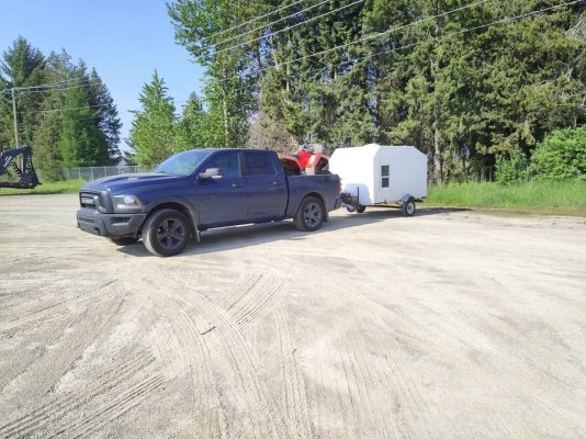

I have the 1211. After driving around the springs wore in and the rear ended up sitting about 3/4 lover than the stock springs. They did carry weight much better than the stock springs. Here’s about 1000lbs of weight with 1211.
I’ve now added a small spacer so I’m not close to the bump stops with the quad and trailer.
I’ll dig out some more loaded pics when I find them.
