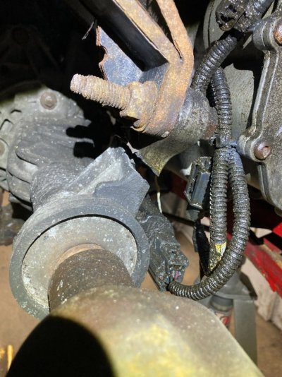

I just realized I am in a similar situation. My front diff cracked and need to get a replacement. It's 392 geared so would need similar swap. 100k truck I just rebuilt the whole lift and new tires so need to keep costs reasonable. It's a 5.7 sport 1500 short bed crew cab. 2017. Vin 1C6RR7MTXHS625121. Local aftermarket vendor did pro comp 6" lift gears and it's riding on 37x12.5x20 nittos.1000003246.jpg

I just realized I am in a similar situation. My front diff cracked and need to get a replacement. It's 392 geared so would need similar swap. 100k truck I just rebuilt the whole lift and new tires so need to keep costs reasonable. It's a 5.7 sport 1500 short bed crew cab. 2017. Vin 1C6RR7MTXHS625121. Local aftermarket vendor did pro comp 6" lift gears and it's riding on 37x12.5x20 nittos.View attachment 537130
Hi,
The front diff shows on backorder but we may be able to source one from another dealer if your interested
Let me know,
- Benny
