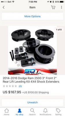

Anyone had any experience with these kits and how they look once on the truck

that seems pretty expensive for spacers. with 3" of lift in the front, you should be replacing your track bar as well. at that point, you should probably buy longer coils and shocks as well instead of spacers. if your set on spacers i personally wouldnt do more then 2", but thats just me.

Nothing wrong with spacers, but Id buy a track bar and longer shocks rather than just shock extenders. I installed 5100s all around with my HBS level.

I have shocks on order those extenders just came with the kit as for the track bar I am on the fence as I have heard a few stories about just running my factory till it's worn then going to an adjustable and some say it's a must

With a 3 " kit your front axle will be way off center.
You should get new coils, adjustable track bar and shocks to go with it. spent alot of money on your truck why skimp on it now.

And weather you run taller coil or a spacer it will always shift the axle weather you can see it or not so when I want to clear a 35 a touch better I can drop 1500 on springs or 300 on spacers to accomplish the same result

yes, your axle will shift regardless if you use a spacer or new springs. 3" of lift in the front you should be changing your track bar since it will be way off center, regardless of how you choose to lift it. the point being made is that if your going to change the track bar (like you should), why not do a proper lift with new springs? they can be had for a lot less than $1500. if you have zero intention of changing the track bar, i wouldnt go higher then 2". however, its your truck and you can do whatever you want.

1500 for front springs is crazy, but 300 for spacers is as well.
Thuren or Carli both sell great springs at fair prices.

See you guys are all from the states I live in Canada so 300 for front and rear lift was a fair price you don't get bashed with huge shipping costs

See how fast 900 for front and rear springs with shipping turn in to 1500 also I will pay duty of 5% more to cross the boarder so I went with the more economical way
