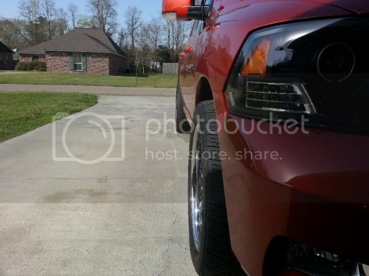

What's the offset of the rims. I'm running 305/45/22 on srt10 replica rims with a +25 offset. I was rubbing the upper control arm. Had to use a 1/4" spacer now everything is fine. I'm also running a 2" level kit just because I didn't like the factory rake.

Height wise yes. It rubs because of the offset. If you go with the 18 offset you should be good. The 25 off set will give you the same problem I had. I think stock is +19 off set. My rims are 22x10

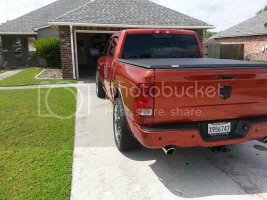

Mine on 305/45/22 Nitto's
These came off a Porsche Cayenne and with the 1 1/2" adapters puts them at around +16 offset.
No rubbing or anything.

Those look amazing, the truck looks amazing!
Tires don't even stick too far out past the fender line either, nice.

To be honest they stick out a little farther than I thought but I'm used to it now.
