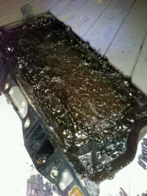

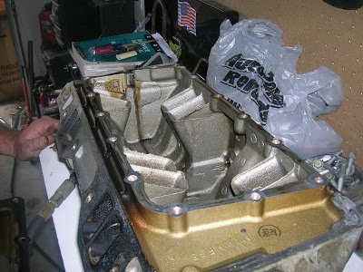

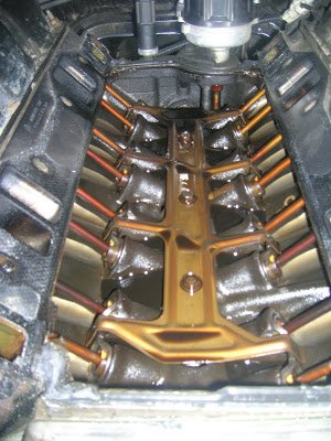

also depends how much you have to clean. I'm still cleaning mine 2 days later. I'm just replacing everything I can now. Don't wait too long or this will happen. I didn't have any trouble until last week and I wish I knew to check it sooner.
Good Gawd... that's just fugly... I thought mine was bad...

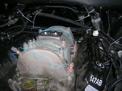

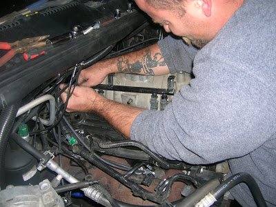

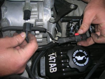

Awesome post! I wish I would have found this BEFORE I started this project. I did get the gaskets done now im in the process of putting it all back together when I realized I have vacuum lines EVERYWHERE, and when i try to move them they start breaking...now I have no idea where they go. Can someone post a detailed picture or something?

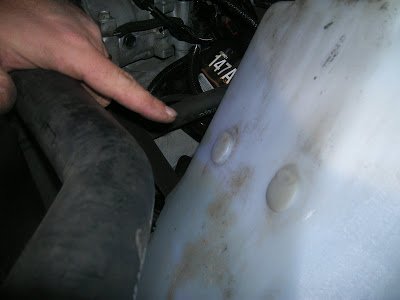

Ok, whats the little intake by-pass hose thing?
Hotroder383
Jan 7, 2012
235
Washington Mo
1996
318 or 5.2 which ever you want
Intake bypass thing?? You talking about the EGR hose?? A pic might help =)
Muddytazz
Oct 15, 2011
508
23
Salem, Or
2013 Ram 2500HD 4x4
Hemi baby
Don't know what to even take a pic of to take one......its mentioned in this write-up but not shown. I'm trying to figure out what it is lol
txbass06
Oct 27, 2010
4,129
56
NE Texas
1996
5.9 Magnum
I think you're talking about the by-pass hose that runs from the front of the intake to the top of the water pump. About a 4" hose with a 90 degree bend in it?
Muddytazz
Oct 15, 2011
508
23
Salem, Or
2013 Ram 2500HD 4x4
Hemi baby
Picture would be great so I can see what what is the purpose?
