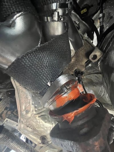

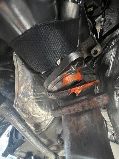

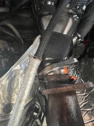

Thanks for the tip on the locking fasteners, I will be experiencing removing the fasteners with head on first hand right away, since I gotta put the stock manifold back on.
The part number I got for the pick up tube is the one that matches the 5.7L 1500. hope that doesn't affect anything with the pump, because I don't want to drop the pan again lol. the headers don't fit so I'm going back to manifolds.
I don't have heat shields currently so I guess I'll run without for now. I'm not working the truck hard anyway, just keep soft stuff zip tied away in the time being. the headers in the instructions say 1961S-1 2003-08 ram 5.7L and 1961S-2 09-18&19 old body style ram 5.7 hemi 1500 only. Not sure what that means but the flange for Y pipe doesn't line up both on angle and diameter, so buyer beware anyone locking to pump headers on their Hemi, hard lesson learned.
